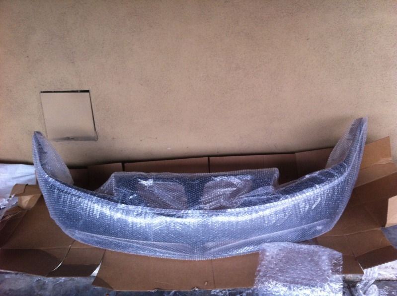

    I received the parts in a little over a week, not bad considering they had to paint it.

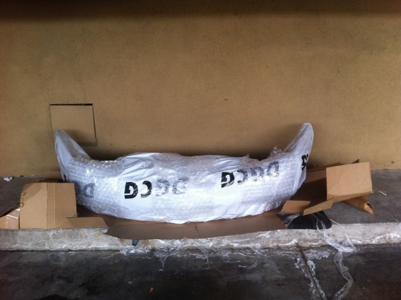

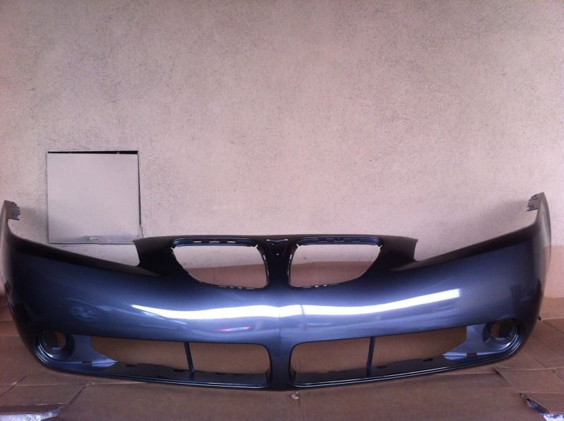

    It was packaged in bubble wrap and a plastic bag then wrapped in cardboard and cellophane.
    I did a paint inspection. I found that there was a run inside where the lower grille goes. But you'll never see that. I also noticed that there are a few small dust particles in the paint. but nothing bad.

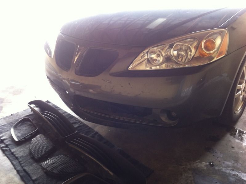

    Off with the old. I used the How To's on this site to remove the upper and lower grilles, along with the bumper cover and absorber.

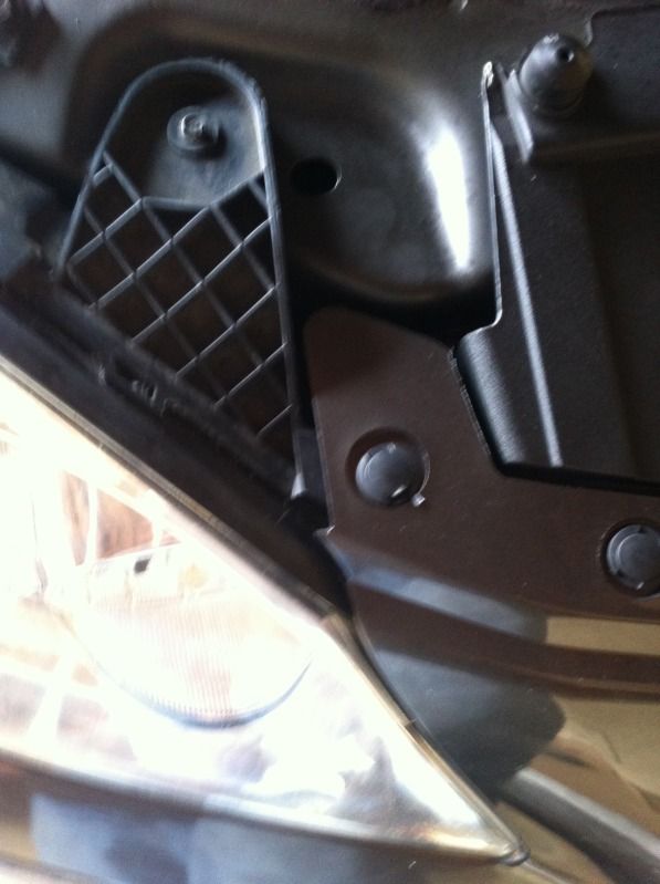

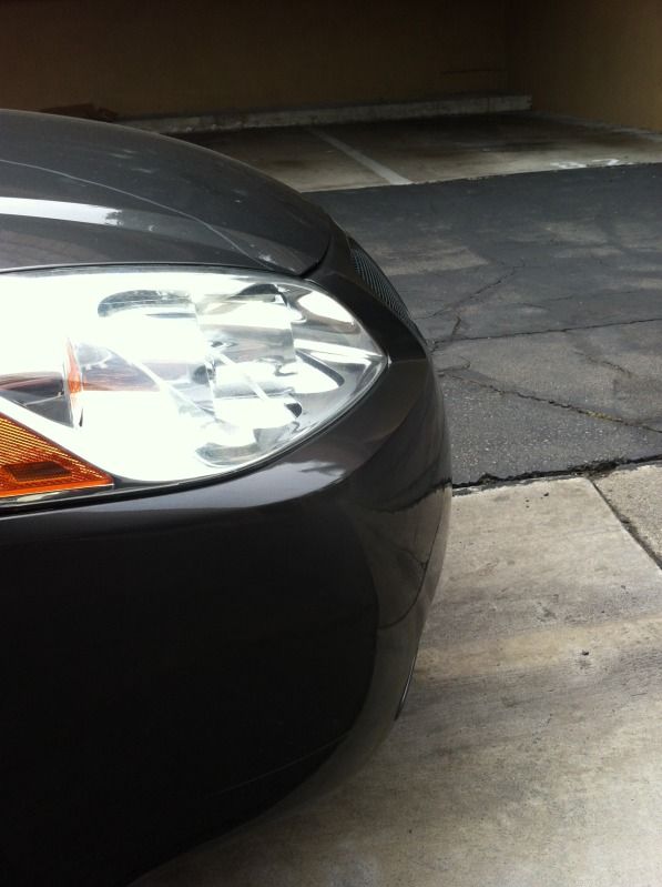

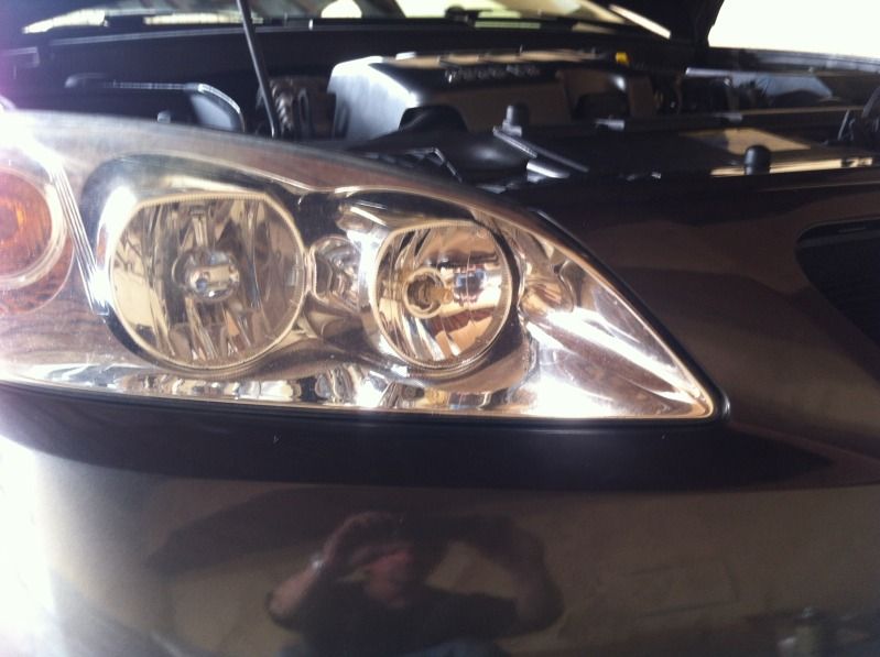

    While installing the replacement cover I elongated this mounting hole so that the cover would line up equally with the headlights on each side. I also bought a package of 15 of those PITA Christmas tree button fasteners for 5 bucks at auto zone.

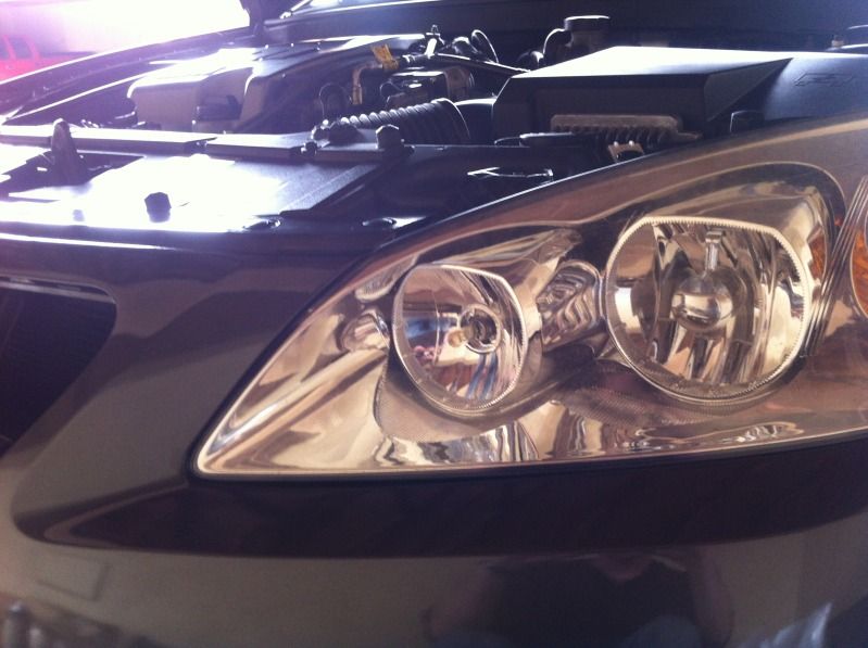

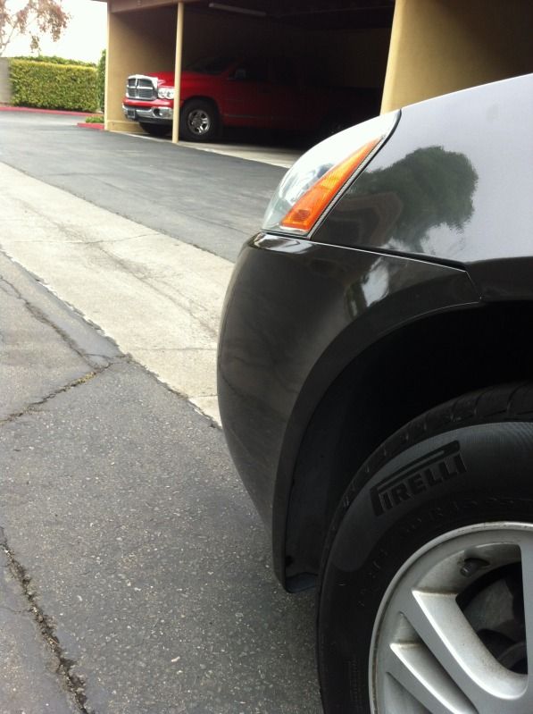

    The original cover was pushed out a little in front of the right headlight corner. Now the replacement fits better than the factory one. I am a happy camper.

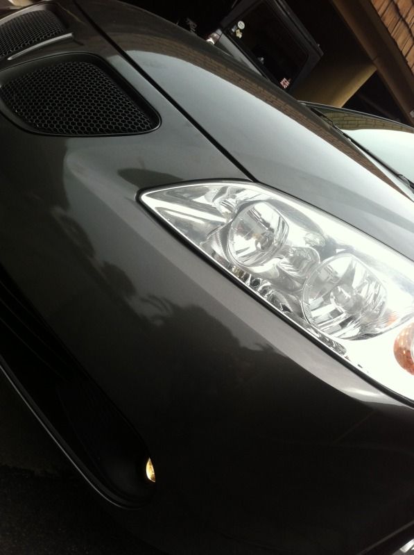

    Here she is looking as sexy as ever Minus my finger prints.

        It's hard to see in this pic but on the old one the head light is behind the bumper. in the corner near the grille.
