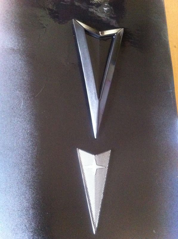

Well my original dart from my from my front bumper was damaged in the accident. You cold see where it flexed and the chrome was starting to chip. I set out to fix/mod it.
I removed the interior clear plastic piece with a mini screw driver, and cleaned all the red and silver paint off. Then I masked off the front side, and sprayed the back side to match my body color. While that was drying. I sanded, spayed primmer and sanded some more. Finally I painted the outer chrome gloss black. Once I was happy with the piano black finish I spayed it with 2 coats of clear coat. In the picture it looks chrome, but it's black. I also used some Mothers polish and my rotery tool to polish the face of the clear piece. I think it looks bitchin' and cant wait to put it back together and put it on the car.

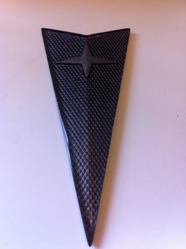

Here is the clear insert after painting on a white back ground.

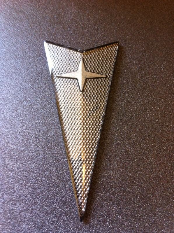

Here it is on a black background, a piece of 800 grit sandpaper.

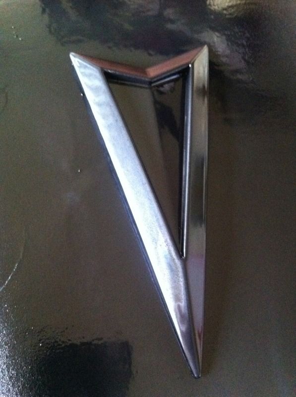

Here is the black surround. it looks chrome. but it's black.
I can't wait to get them put together and on the car!
Any thoughts?
