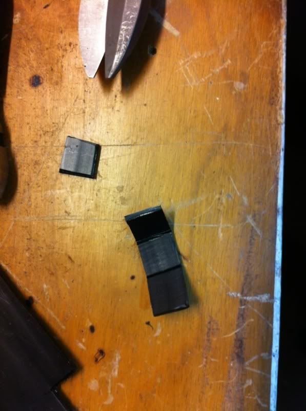

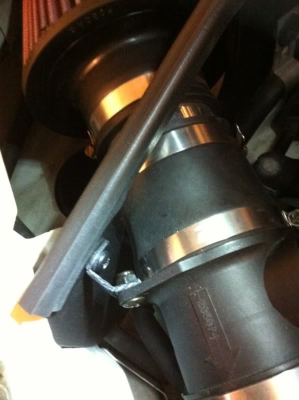

Ok I don't know about the rest of you but my FPU flops around in the heat shield SO my handy boyfriend came up with this hope you enjoy

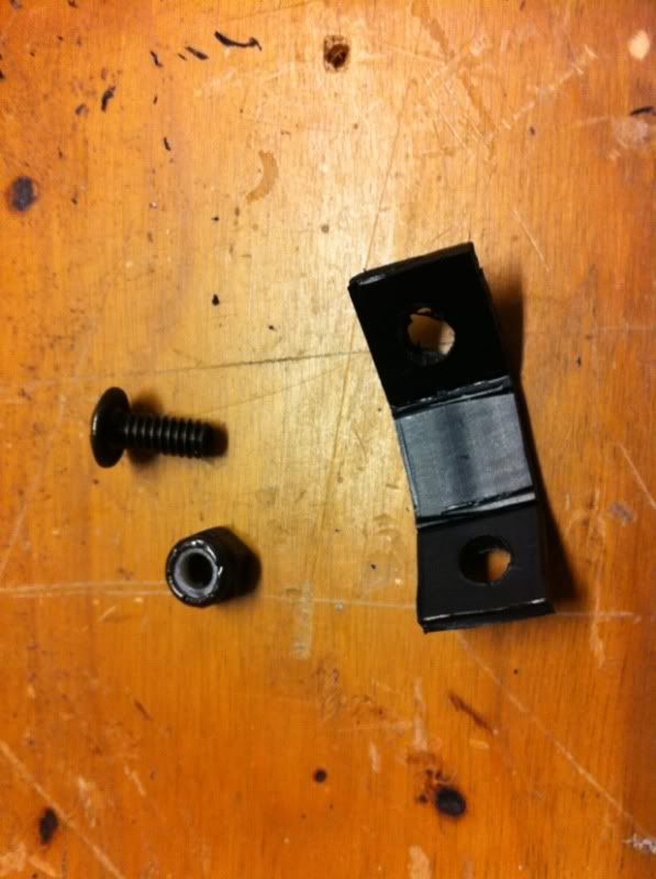

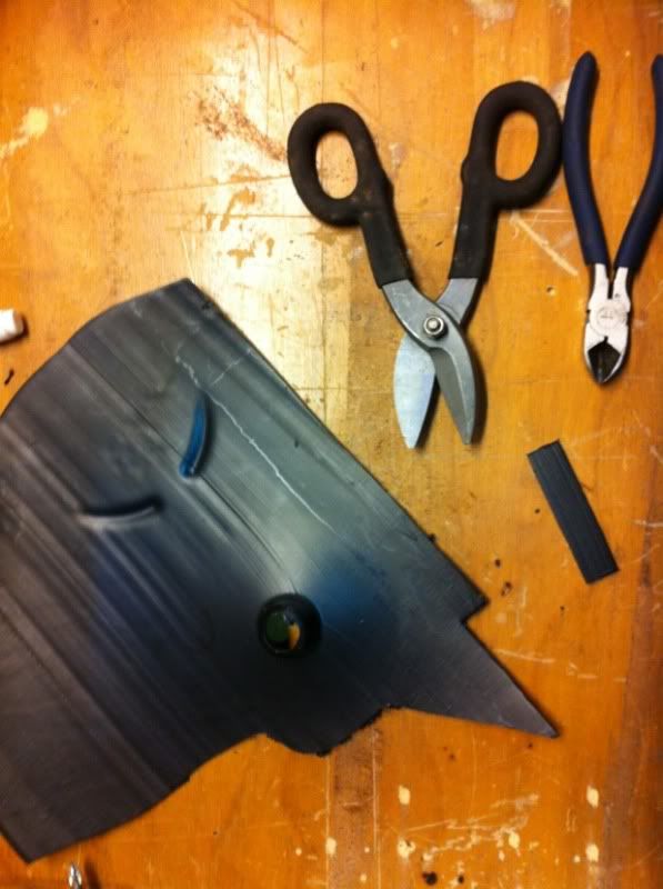

He took thick plastic from back when he needed to cut the center out of a drain pan so he could drain his radiator. He used side cutters and tin snips to cut the piece he needed then used the side cutters to smash the seems so the plastic would bend where he wanted it to.

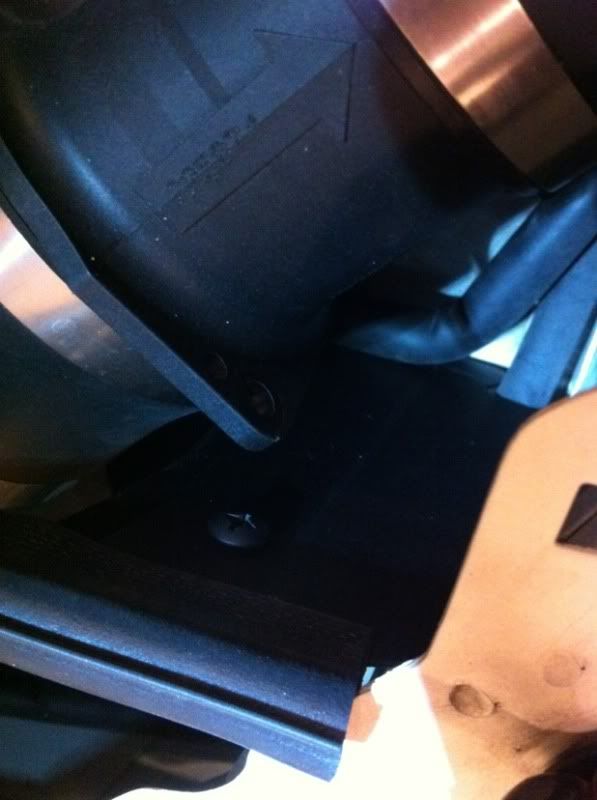

Then he drilled some holes and found a nut and bolt that would work and put it all together and readjusted everything. If someone wanted they could use tin instead but they would have to pre-bend everything then paint it and risk scratching it up
