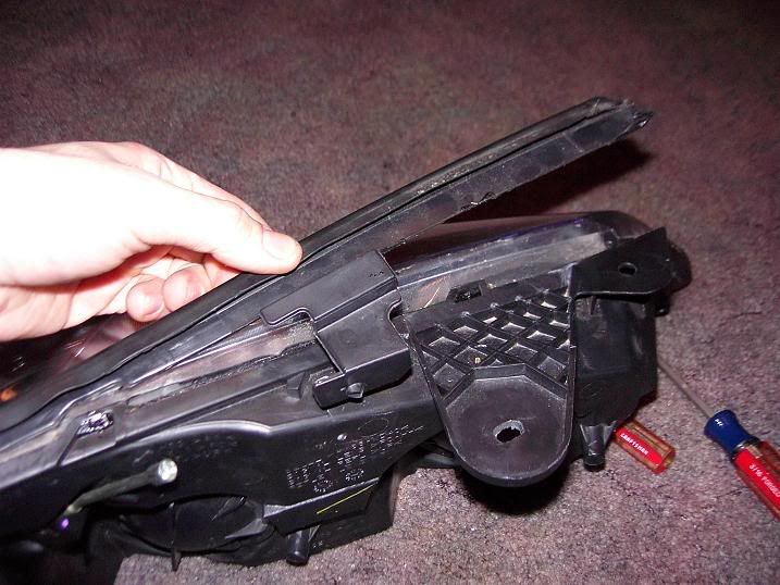

Now you need to separate the headlight. You must take this part slowly and carefully. Now, I’ve taken apart headlights before so I knew how to pry them apart, but if you want to make the job a little easier, get a hairdryer to heat up the edges around the headlight. If the silicone sealant is warmed up it will separate easier. You want to start at the side of the headlight where the amber reflector is. Take a flathead screwdriver and insert it in between the two parts on the headlight as shown
Now move the screwdriver back and forth, you will see the headlight start to separate. Notice the little black plastic clip that holds the other part of the headlight on. There are a few of these on both sides of the light. You have to pry this clip up and over the clear part it holds on or else it will break. Just take the a screwdriver and insert it under the clip. Lightly twist it until it starts to come up. Now with the other screwdriver, continue to pry the headlight apart, while at the same time twisting the other screwdriver to pop the clip off the little clear knob on the other half of the light. Again, it’s really no big deal if you break these little clips.
Now, take a second screwdriver, and insert it further down towards the center of the light, and pry that section open. You need to keep moving the two screwdrivers down further and further until you reach the other end of the headlight. And don’t forget to pop up the little black clips you encounter. I believe there are three on each side (top and bottom).
Once you get the end of the headlight, go back to the other side where you started (by the reflector), and work on the bottom of that side. Insert the screwdrivers and start to pry it apart.
Continue along with bottom the same way you did the top, carefully prying the headlights apart and popping up the little black clips. Once you get towards the end you’ll be able to just pull the headlight apart with your hands, and you’ll have the following:
