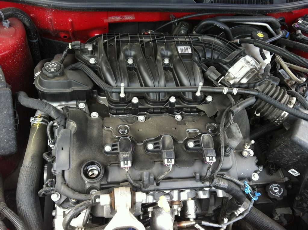

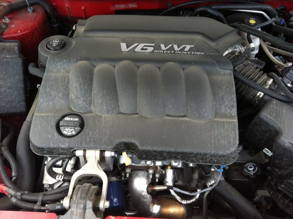

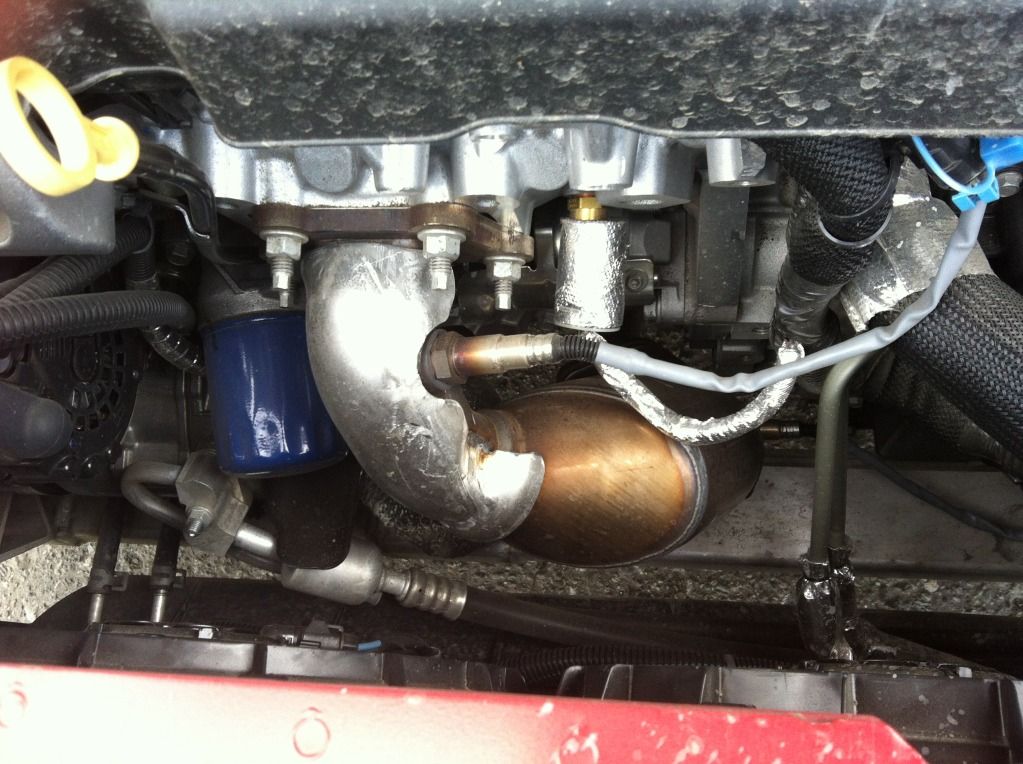

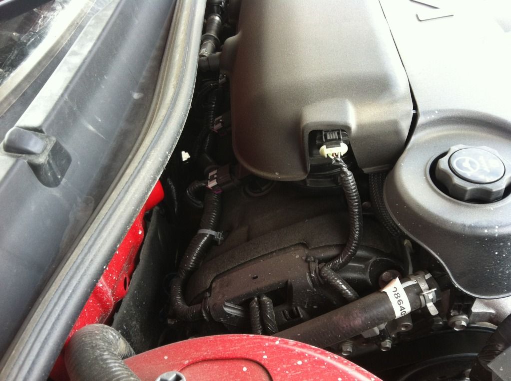

    I'm here in Alaska on vacation and we rented a 2012 Impala with the new LFX 3.6 DI engine pushing out 300HP and 262ft/lbs of TQ. Before anyone says it, I know it would be costly for only ~+50HP and ~+11lb/tq but I was just putting it out there for discussion since it is in a FWD application and not a RWD like the LLT. Any who, here are a couple pics from under the hood...

      Back in the day the 3.6L LY7 in the G6 was shared with other platforms. In the G6 it got 251hp 252ft-lb. In other vehicles, including the CTS, Torrent and Equinox I think, all had a different version with a different intake manifold that outputted something like 261hp and 270ft-lb or vice versa.
      The new LFX most likely has the same layout as the original LY7 for other vehicles, since the Impala has a fairly large engine bay since it once house the 5.3L LS4. The LFX in the Camaro and other vehicles have this different intake manifold as well.
      If you really wanted to do it, electronic support and ECM BCM issues aside, that might be your only problem. Doubtful the LY7 G6's intake manifold would bolt up to it though but theres a chance.

          Well if you had a car with a fried engine, maybe. The air intake is on the wrong side, the engine mounts are different and you would have to replumb all the lines for power steering and brakes. The back support for controllers to run it seem to top it as impossible to retro fit. However that being said they did put LS engines in Solstices, with factory support help.
