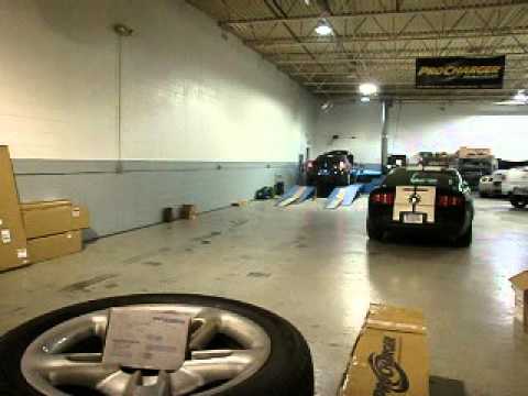

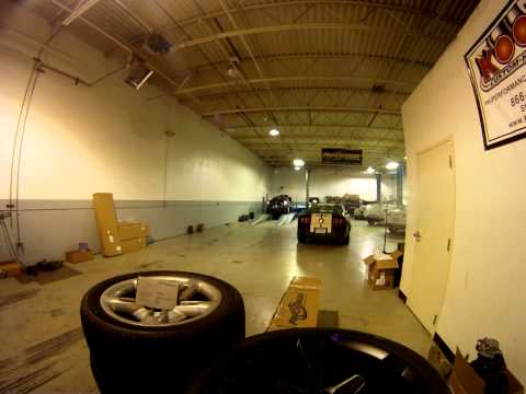

    well heres 2 videos and a dyno sheet of a VERY dissapointing dyno..... im not sure what went wrong whether they dynoed it in 6th gear or what but according to this dyno im only putting down 202tq and 204hp with intake, headers, full exhaust, 93 tune, race MMIs and the new intake manifold were working on, where as other members with the same mods minus the manifold are putting down 220-225hp/tq theres no way this manifold with more volume than stock should LOSE 20hp/tq........ if anything with the bigger volume it should have loast a little bit of low end torque trading of for a LARGE increase in high end HP...... the guy that designed this manifold was looking at my dyno and notice that mine looks almost identicle to nates, who has the same mods minus the intake with exception that mine appears to be droped down on the scale by about 20hp........
    i guess the only way to get to the bottom of this is to have her redynoed elsewhere on a dynojet and do 3 pulls with the new manifold and 3 pulls with the stock manifold.....
    anyways here 2 videos of the same run, and the graph
