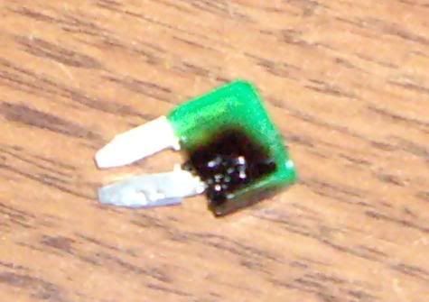

                    Ok I pulled the fuse, and this is what I saw:
                    That whole side was totally burned and melted. I'm no fuse expert, but I know when I fuse blows, the metal piece inside becomes unlinked, not the whole thing melts. I pulled the relay out too for the heck of it, it looked all right, with the exception of some small burn-type marks on one of the prongs.
                    Anyway, I replaced this fuse with another one, drove around a bit with the defroster on, and checked it again. Same thing, but not as bad (yet). The plastic on that same side is bubbling up and starting to melt again. E2helper man, you have any ideas? The dealership has never touched the car since I bought it.

                      Wow, that actually looks pretty scary. Fuses aren't supposed to do that
                        that's not good!!
                          Would something happen to short circuit your defroster mesh or some other wiring along?
                          Only thing I can think of doing that is the same thing blowing a fuse: overcurrent. But in your case the current is large enough to generate much more heat and melt it.

                            Ummm... yeah. I'm gonna say that that looks bad.
                            Like Toni said, it appears to be overcurrent. Bad overcurrent.

                              i would say theres a short somewhere that pretty bad if its melting the fuse
                              just a FYI question you didnt repalced the fuse with a Harbor Freight fuse did you? theres a bulletin talking about a recall on them
                              Concerns with Harbor Freight Tools "Storehouse" Branded Blade Type Fuses
                              General Motors has become aware of a fuse recall by Harbor Freight Tools/Storehouse for a variety of aftermarket fuses. In two cases, these fuses have not provided protection for the wiring system of the vehicles they were customer installed in. Upon testing the 15 amp version, it was found that the fuse still would not "open" when shorted directly across the battery terminals.
                              How to Identify These Fuses
                              Packed in a 120 piece set, the fuse has a translucent, hard plastic, blue body with the amperage stamped into the top. There are no white painted numbers on the fuse to indicate amperage. There are no identifying marks on the fuse to tell who is making it. The fuses are known to be distributed by Harbor Freight Tools but there may be other marketers, and packaging of this style of fuse. It would be prudent to replace these fuses if found in a customers vehicle. Likewise, if wiring overheating is found you should check the fuse panel for the presence of this style of fuse.
