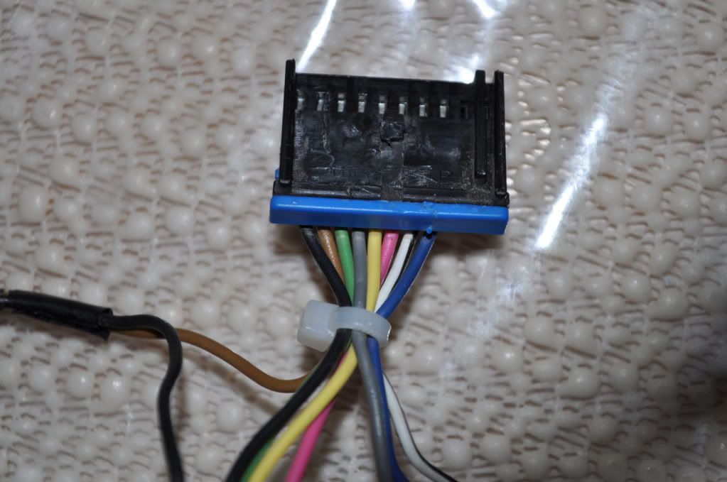

      Hey Ahuhn,
      I know I have the support for the volume controls, however. I got a harness for I believe a 06 g6,(I have a 07 g6) and the wires dont match up. Do you happen to know which order they would be in? I have attached pictures of both the harness and the steering coloumn wires. The other thing is, the way the harness in positioned in the picture is the way it plugs into the connector. Atleast, that is the way I took it out from the 06 G6. Unless I just plug it in without switching any wires on the connectors?

              Update..installed the steering wheel control on the g6. It guess the color of the wires don't need to be modified. Just plug n play.. and it worked. But like everyone else.. buttons aren't synced properly. But as long as volume and changing tracks works.
