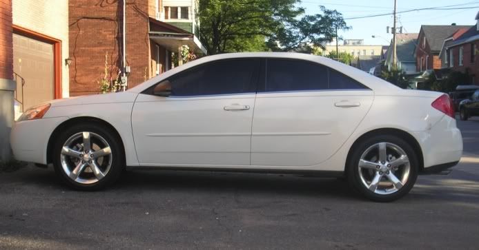

    Hey Everybody,
    The solstice rims were delivered saturday evening, and man are they Hawt!!
    This picture doesnt even do them justice, they look much better in person.
    They do fit, but they do every so slightly touch the struts.
    I dont hear or feel any rubbing, but i'm sure they do at least a little.
    I am going to look into some spacers to offset the offset.
    I was prepared to sell them if they didnt fit, but they look so good that i'll make em fit.
    I havent been able to get the smile off my face since i put them on
    I love the looks the car gets now when im at a light

    They do look great on the 6er, but definitely do something about that strut rub. I have seen a few GTOs get taken out due to strut rub
    Hurricanes are like women : when they come, they're wet and wild, but when they leave they take your house and car.
      Glad you got 'em. They do look hawt!
      Get spacers quick. You'll tear thoses tires up.

                  so why do they rub? they aren't the same size at the orginals?
                  2008 Chevrolet Cobalt SS T/C
                  Black/Black coupe
                    They are the same bolt pattern, but the offset of the solstice rims are 55m when the offset of our 6ers are 42m.
                    The difference in offset brings the inner edge of the wheel closer to the struts.
                    I'll pick up some spacers to make up the difference between them which will cause the rim to not sit so far back.
