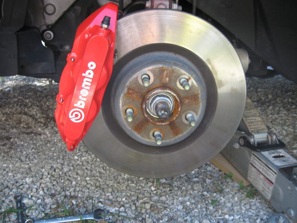

            i just cleaned them up real well and installed the new studs and 15mm spacers so ill post pictures tomorrow

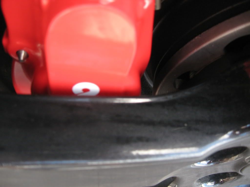

                            yes. you will need spacers. at least 5mm, albert and i went 15mm simply for the wider stance and clearance to clean them. i called many rim companies and the biggest offset they offer is 42mm. i think the brembos require a 45mm offset. so basically you will need spacers.
                            if you run anything bigger then 5mm, you will need to get longer wheel studs like we did.
                            as for pictures, they are in the thread just look. but for the lazy ones heres pics again
                            this picture is with the 5mm spacers, just too close for me.
