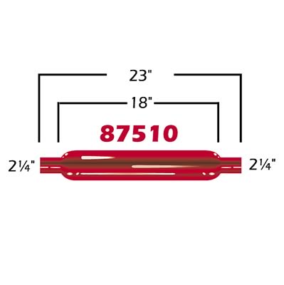

    ^^ That should fit. You may want to measure first though. You'll want the dual outlet valance.

      Free Shipping - Cherry Bomb Glasspack Mufflers with qualifying orders of $109. Shop Mufflers at Summit Racing.
      Free Shipping - Dynomax Super Turbo Mufflers with qualifying orders of $109. Shop Mufflers at Summit Racing.
