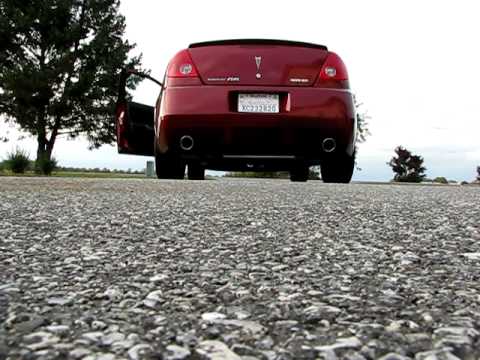

Originally posted by lueshe View PostI installed my CRAB intake a few weeks ago, and finally installed the new exhaust on Friday. I went with:
2.5" to 4" tips.
It has a nice low rumble to it until I step on it. Overall, I'd say i'm satisfied. I need to take pictures and put a video together.
this is the best sound ive heard while looking through exhaust clips, i know you said you dont know much about the 3.5 but do you know if anyone has used a similar setup as yours on a 3.5 already,,, i cant find one there are sooo many clips and exhaust posts lol
