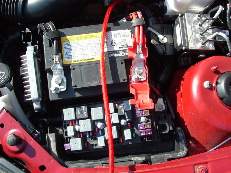

    To all G6 audiophiles:
    What do you make of the battery connection on my new '08 ?
    The main connection looks pressed on - Is there now a special tool to
    remove the battery ? I have my components on order amp, box, and cable.
    The battery connection should match my nice thick 4 ga. cable or it's a waste.
    There is a small threaded post on the terminal, but it does not look like it
    could offer much surface area to a terminal. Who has put in a nice high current
    solution and might you have pics?
    Thanks !
    Re: Getting a really good battery connection
    If you take off the other cover in there beside the battery, for the fuse panel. There is a red cable that runs to the battery. You can see it in your pic, it runs to the fuse panel. I have mine hooked up to it in the fuse panel there is one bolt that does it up and it seems to work good.

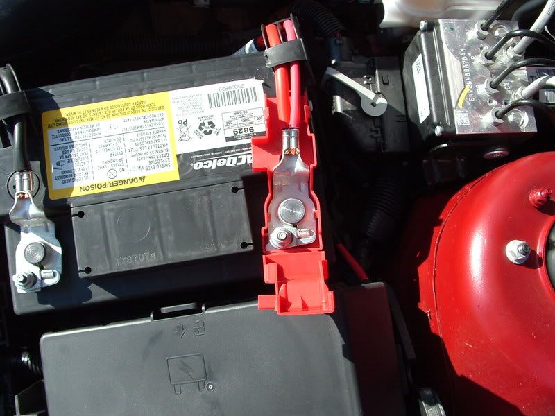

        you remove the cable by undoing the 10mm nut and when you do that it loosens up and comes off easily
          Excellent info guys. Here is a shot of the fuse panel. Connector is OK, not great. The wire is not as large as the one going to the starter motor, and even that is smaller than the 4 ga. power cable I bought. Now that bolt on the battery clamp is interesting. I did not think it was a tensioner because of the vertical orientation.
          Will have to get onto that nut tonight and see if it loosens the clamp.
          If so, some type of slim clamp could go in under the factory one.
            the best thing to do is to hook up your power wire right to the battery on that 10mm that holds the battery connection i have 0ga power wire for my system and that is the best place for it i just had to notch out a piece of my battery cover to get the wire out and you can do that with a dremel or a bench grinder i'll post some pics when i get my new computer
              Dont ever run anything from the fusebox, that is the worst place to hook anything up from due to power surges etc. Run your power wire is a ring terminal from the the 10mm bolt.
