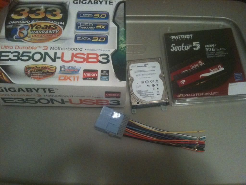

    Basically I'm about to install a computer into my G6. A few of the features, aside from obviously a music library, include GPS, Radar, WiFi, USB LED control, and OBD-II.
    Eventually I want to get some voice recognition going, rear camera, and an LCD to replace the Speedometer cluster, HVAC integration..
    Here are the parts I have now..

                      Full Specs:
                      GIGABYTE GA-E350N-USB3 Mini ITX
                      AMD E-350 APU (1.6GHz, Dual-Core)
                      AMD Radeon HD 6310 graphics
                      Audio Channels
                      8 Channels
                      Onboard Gigabit LAN
                      1 x PCI Express x16 slot (For wireless)
                      1 x PS/2 keyboard/ mouse port
                      1 x D-Sub + DVI
                      1 x HDMI
                      4 x USB 2.0
                      2 x USB 3.0
                      1 x Optical (S/PDIF Out)
                      8Gb DDR3
                      500Gb 2.5" SATA (Springing for a SSD around Christmas)
                      The screen is a 7" Samsung LED LCD w/ Resistive touch. (Capacitive is out of my price range at the moment)
                      The screen receives HDMI, D-Sub, &/or A/V.
                      Physical Keyboard/Mouse is a Lenovo N5920 Multimedia Remote
                      I'm an Intel man, but the Intel Atom Mini-ITX boards don't offer as many features in my price range. I paid $90 for the Gigabyte board. The monetary drawbacks of being a college student.. smh
                      (Edit) Oh and the power supply is a M2-ATX 200W PSU, forgot to mention that in the specs
