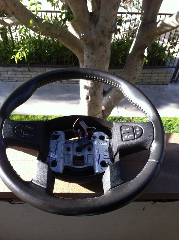

    I swapped out my wheel because the vinyl one was deteriorating.
    I bought the leather wrapped 4 spoke with radio controls. After reading about others doing similar projects. I found that I had all the wires needed for the radio buttons. After I was done I was pleased to find out that all the buttons work and perform the proper functions.
    All in all it was very easy. Be sure to disarm the airbag.

        I got mine on E-bay, I won the bid at $0.99. Airbags are no joke, approach with cation. knowledge is key. There is a wealth of information on this site alone. It's actually pretty simple.

              Thanks for your input, My justification is pretty simple. I don't have the 3 spoke GT wheel that you have.
              This is my original wheel...
              You can see that the vinyl coating is pretty much shot and is wearing into to the foam that will eventually wear to the steal frame.
              In addition to the wear. The replacement contained radio controls, where as the original only had cruise controls.
              The replacement radio controls light up and match the dash lights.
              The original only had a bright yellow LED that came on when the Cruise control button was pushed in.
              So for what I paid $0.99 + $20.00 Shipping, it seemed logical. I would have like to have switched to the three spoke wheel that you have but I would have needed a new air bag and they rub $300.00 to $500.00
